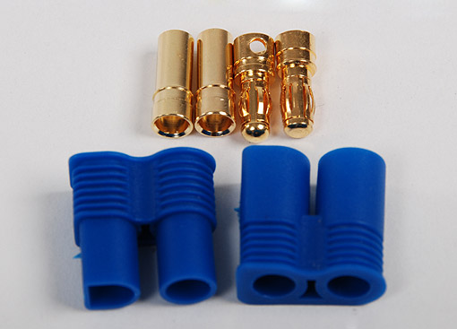

ec3.jpg [ 37.46 KiB | Vist 25444 ganger ]
